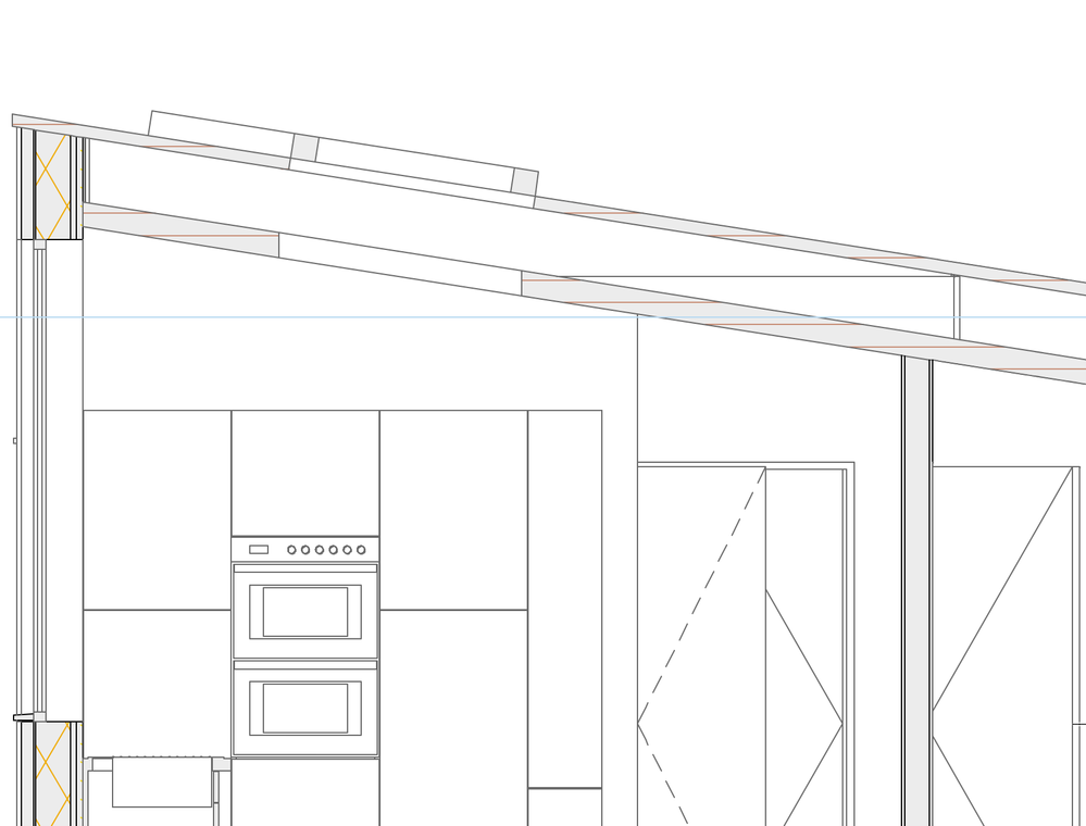

I have inserted a roof light into the monopitch roof of my model which is fine - but I need to extend the internal lining of the roof light to extend through the void between the external roof and the ceiling below (which is at the same angle as the external mono pitch roof).
Tried everything I can think of. Can anybody please help.

Easiest way is to include the ceiling in the roof composite. If that's not an option then the next easiest way should be resorting to morph. In 3D view, open the skylight setting and set the 3D representation to Full. Duplicate the skylight in place and convert the copy into morph (right click and "Convert selection to morph" ). Ungroup the converted morph skylight and delete everything except for the lining. Use the pet palette Push/pull to extend the lining edge to desired size. Open the skylight settings and turn off the lining.
It is unfortunate that we don't have lining depth parameter in the skylight settings..
