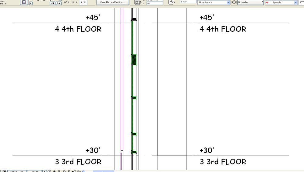

Hi Gerald,
Here is a sreen capture of the situation (section)
The window is the same hight as the floor but it is vertically offset by 3.5", so it pops up in the floor above by a little --> the symbol cut shows up on the next floor too. I'd like to set it so that it only appears on it's home story.
Best,
Adam
Djordje
Change the window floor plan display mode to Symbolic
Djordje
ArchiCAD since 4.55 ... 1995
HP Omen
