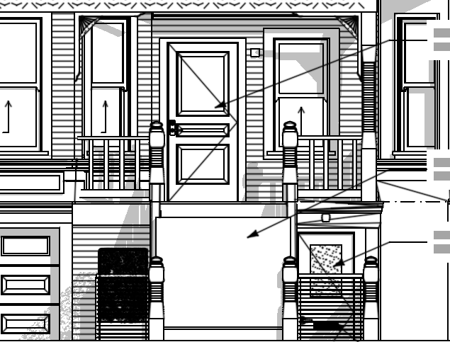

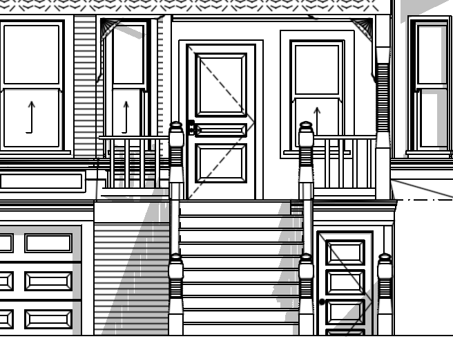

I am having an issue where, in elevation only, a stair is covered by what appears to be a fill of some sort. It shows up in my new elevations, but not in my existing (this is a remodel and I'm using the renovation filter). It also does not show up when I cut a section through the same plane as the elevation. I imagine this is a headroom plane or some graphic override but I cannot for the life of me figure it out.
This "fill" also sometimes appears in 3D as a ghosted box, but I can't seem to replicate that right now...
Existing Elevation:
New Elevation:
One thing to check is Model View Options (MVO) > Stair Options > Headroom.
David

David:
That's exactly what it was - thank you so much. I just couldn't figure it out!
