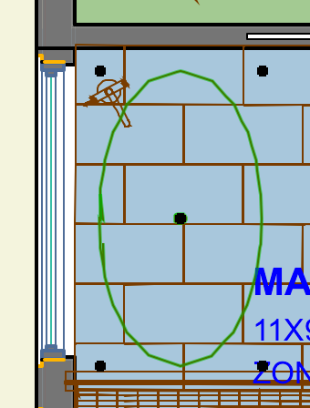

Floor tile showing through object in plan view
The bathtub below was created from Sketchup and placed on top of a tile floor. Why is the tile floor showing through the tub? I assume something in my object settings is wrong but played around for it for a while and can't figure it out. Thx for your help.

2D plan views are not a projected plan view, you wil need to add a background fill under the bath

Try converting the bathtub to a morph, setting it up with a cover fill and saving it again as an object.

This thread may help if you want to edit the 2D Symbol of the object: 2D symbol of Archibase.net objects.

Thx a million David;
That's exactly what I was looking for. Works like a charm. For all, here is David's workflow to accomplish this:
I think the procedure should go something like this:
1. Open the library part
2. Go to the 2D Full View window, Select All, Copy
3. Go to the 2D Symbol window, paste (this will put the 2D symbol in the correct location for the 3D model)
4. All the lines and hotspots come in on fragment 1 (like a layer), you may want to change the line fragment assignment so the lines can be more easily selected later for deletion.
5. Use the 2D tools to draw the symbol on a different fragment, using the copied lines as a guide, leave the hotspots (or add/delete hotspots as desired)
6. Select the copied lines and delete
7. Go to the 2D Script, select all, and under the Edit menu, select Comment, this will add a "!" before each line of the script so it is not read, but preserves the code
8. Save or Save As the library part
You should now have a library part with the drawn symbol in the correct location and the original 3D model. The 2D Script for this part is 2000 + lines of code, so I don't think editing the code is practical.
