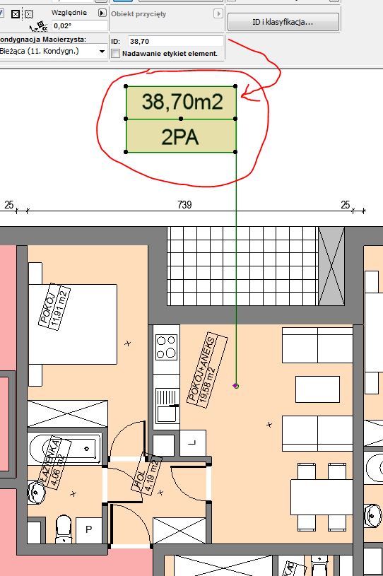

I' m making a custom "apartment label" in which object ID is the netto area of the whole apartment (sumed manualy and typed in by hand).
I will need to make a schedule of those apartments with an option to sume the apartments areas.
So what is needed is to convert object ID into a real number which further could be scheduled and sumed up.
I've tried this but it doesn't work:
area = GLOB_ID
n = SPLIT (area, "%n", num)
Text2 0, 0, num
so, the value "num" was supposed to be that "real numebr" which could be multiplied, sumed etc...
The objects ID is for example a text: 38,70 (with a coma typed in on the numpad but could be also a dot)
any ideas ?
The whole object "label" works like this:

So.... coming back to the GDL problem...
It looks like the GLOB_ID is a "variable" which can't be recognized as a real number. The code below shows the problem:
area = "7,35"
!area = GLOB_ID !     Object ID is now also 7,35
n = SPLIT (area, "%n,%n", num1, coma, num2)
number = num1 + num2
Text2 0, 0, number     ! Should be 7+35=42
When AREA is typed in the code by hand as text consisting "7,35" it works, the answer is 42 ( =7+35),
but when AREA is the ID of the object which is also a text "7,35" the SPLIT command seems not to be able to split it into numbers.
Any ideas ?
