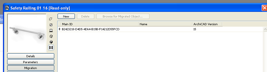

GUID and new dialog
2012-09-27
09:38 AM
Can anyone tell me something about the
migration
options in the object editing window? How does it work?

If you migrate object(s) in the backward/forward migration scripts, you have to entered the Main ID and its AC version number of the old object in this migration table.
