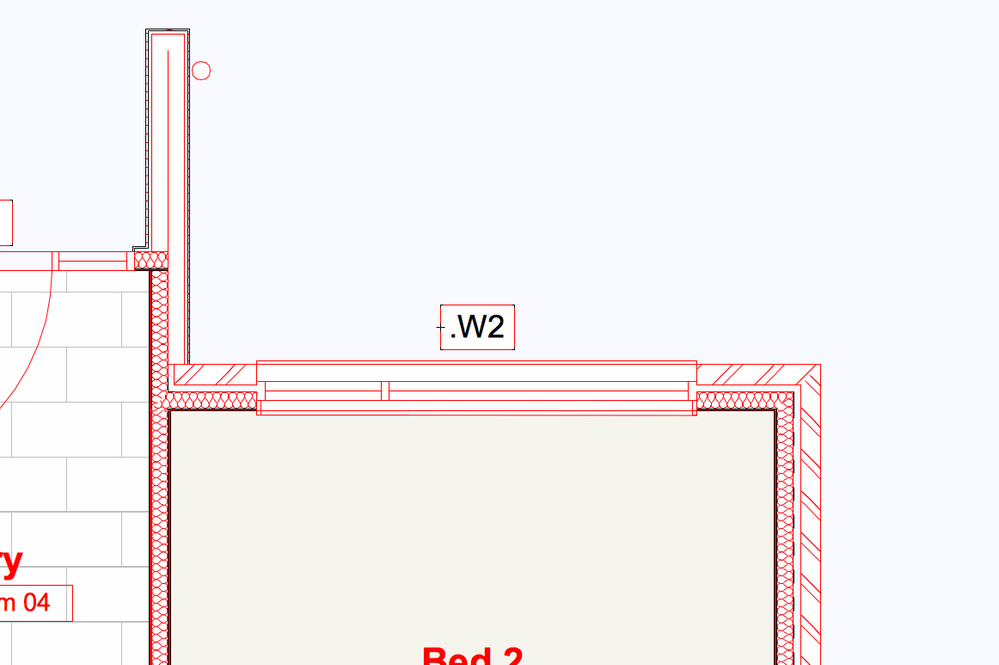

Wokka
Thats what I thought, till I tried the ID label...

Wokka
Master File

Lachlan Green
Interesting find. I haven't looked at the standard ID label for a while now and pretty much forgot of it's existence.
