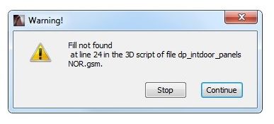

Problems with fills in 3D after upgrading to v18
When i open 3D window i get this message.
Does anyone know how to fix this?

Trine:
One or more of the fills that the library part wants to use is missing from the ArchiCAD project file, see this thread:
Library Parts Not Working Properly.
Based on your screen shot, this looks like a macro for interior door panels, so check your doors to see if you can find the missing fill, and change it to one of the fills in the project file.
