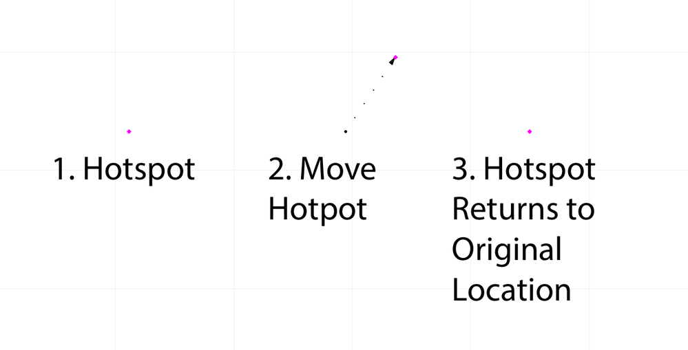

I am trying to create a graphic toggle switch with Hotspots. Basically, I would like to drag a hotspot away from it's original position, release it, make changes to the object based on the dimensions of where it was released, and then return the hotspot to its original position. Is this possible?

If GLOB_MODPAR_NAME = "hotspot_param" then
if hotspot_param > .0001 then final_dist = hotspot_param
parameters final_dist=final_dist
if hotspot_param > .0001 then hotspot_param = 0
parameters hotspot_param = hotspot_param
endif
that should work in the master script.

Thank you both for your reply.
Seneca - what you are proposing seems like a winner, but I can't get it to work.
Andro - I can get your method to work beautifully in one axis. However, ideally, I would like to get it to function on both the x and y axis simultaneously.
I have attached 3 different objects, TESTER, TESTER 01 and TESTER 02.
TESTER roughly works as I would like it, except for one vital piece. It does not return the hotspot back to the origin.
TESTER 01 is built off of Andro's method, and works in the X axis only.
TESTER 02 is attempting to use Seneca's method, but doesn't work.
I can post the code snippets if that works better.
After seeing what you were trying to do I just had to modify the code a little.
master script:
UnIDtest = 1
If GLOB_MODPAR_NAME = "cornerLX1" or GLOB_MODPAR_NAME = "cornerLY1" then
	cornerLX1 = cornerLX1
	cornerLY1 = cornerLY1
else
	if cornerLX1 > .0001 or cornerLX1 < -.0001 then
		cornerLX1 = 0
		parameters cornerLX1 = cornerLX1
	endif
	if cornerLY1 > .0001 or cornerLY1 < -.0001 then
		cornerLY1 = 0
		parameters cornerLY1 = cornerLY1
	endif
endif
	if cornerLX1 > .0001 then
		IF cornerLX1 <= 2 THEN figx = 1
		IF cornerLX1 >2 THEN figX = 2
		IF cornerLX1 >5 THEN figX = 3
		IF cornerLX1 >8 THEN figX = 4
		IF cornerLX1 >11 THEN figX = 5
		parameters figx = figx
	endif
	if CornerLY1 > .0001 then
		IF cornerLY1 <= 1 THEN figy = 1
		IF cornerLY1 > 1 THEN figy = 2
		IF cornerLY1 > 3 THEN figy = 3
		IF cornerLY1 > 5 THEN figy = 4
		IF cornerLY1 > 7 THEN figy = 5
		parameters figy = figy
	endif
2d script:
!!******* HOTSPOT CONTROL *******
		!! X Dimension hotspots
		HOTSPOT2 0, cornerLY1, UnIDtest, cornerLX1, 1+128 : UnIDtest = UnIDtest + 1
		HOTSPOT2 -1, cornerLY1, UnIDtest, cornerLX1, 3 : UnIDtest = UnIDtest + 1
		HOTSPOT2 cornerLX1, cornerLY1, UnIDtest, cornerLX1, 2 : UnIDtest = UnIDtest + 1
		!! Y dimension hotspots
		HOTSPOT2 cornerLX1, 0, UnIDtest, cornerLY1, 1+128 : UnIDtest = UnIDtest + 1
		HOTSPOT2 cornerLX1, -1, UnIDtest, cornerLY1, 3 : UnIDtest = UnIDtest + 1
		HOTSPOT2 cornerLX1, cornerLY1, UnIDtest, cornerLY1, 2 : UnIDtest = UnIDtest + 1
