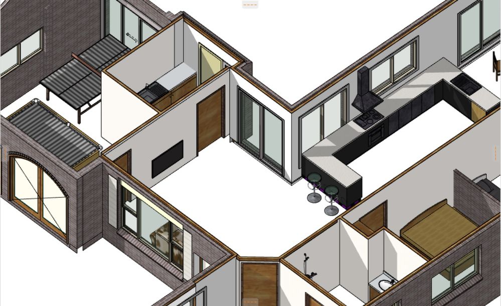

Hi guys, thanks for getting back to me. My apologies if i am asking basic questions or doing silly things wrong, i have only been using Archicad for a month or so as part of my course!
Have attached a jpg of how things look at the moment in 3D. Examples of what i am talking about is the 'games room' in which i placed a ping pong and pool table but the surfaces of both are set to 'pine' 'ceramic tiling' and 'sheet roofing' which were materials i used for creating the building itself.

All objects have default material settings that a saved with the object.
So in the case of the pool table it might be 'green felt' for the top.
But Archicad doesn't really care what the material is called - it uses an index number to call the material up. So the pool table might use green felt - index '24'.
Your template will also have a material '24' but it may be set to 'sheet roofing' which is why the surface material seems to change.
Each file you use may have surface '24' set as a different surface material which is why it is important to always try to use a standard template.
As I mentioned in another post certain libraries are designed to work with certain templates.
I find it handy if ever modifying any surfaces (or any other attribute) that you duplicate them first and modify the duplicate.
That way the original remains unchanged and will still work as it was supposed to.
It is hard to say exactly what is happening for you without seeing the file and the objects involved and not knowing what you may have done to them.
But if you have been modifying material attributes or you are using objects not designed for use in your template that would explain what you are seeing here.
Fortunately you will probably be placing only one pool table in your model so simply change the materials to what you want.
If you modify the 'sheet roofing' material back to 'green felt' now your pool table will be correct but your roof will be green.
