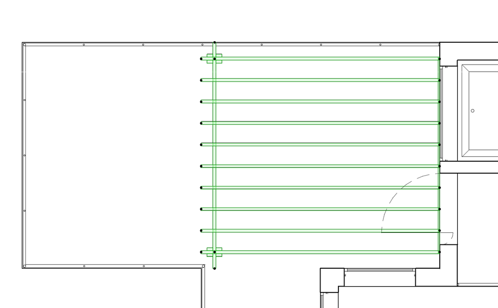

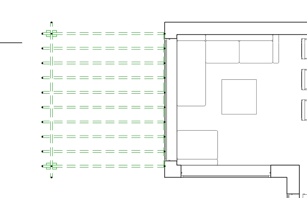

Greetings, I have these Pergola objects (made with the frame vine library part) on multiple stories. they are 3m tall and I would like to display them with overhead lines. This works perfectly fine for the ground floor plan, but not for further stories. I have injected the same object parameters into every one of them and I have the same view settings on every story plan, yet the lines on the upper stories still aren't the types I want them to be. there are no graphic overrides active.
attached below are screenshots of the 1st story and the ground floor plan. the one with the dashed lines is the ground floor plan, and is what I desire all the plans to look like.

I'm only showing the objects on their home story, but the objects on all stories except ground floor don't show the lines as overhead lines, like they do on the ground floor. If I had not checked them already, I would have assumed the cutting planes are different, but they are all the same on every floor
