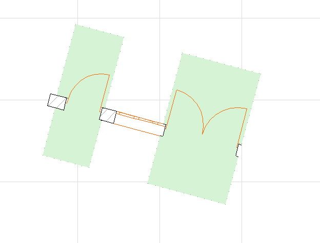

Help ! Strange plan view of Door!
It's so strange that the plan view of the door is shown as the picture below. I could not find the setting to omit the green frame. Please help!

Karl Ottenstein
Moderator Emeritus
In your Model View Options, you have the checkbox shown below checked. Just uncheck it (and save that state in your named Model View Option set associated with your saved Views).
Karl
AC 29 USA and earlier   •   hardware key   •   macOS Taho 26.1 MacBook Pro M2 Max 12CPU/30GPU cores, 32GB
vistasp
You're using AC14, right Kent? You should add your AC version, OS and hardware specs to your signature for better help on this forum.
Go to Model View Options and in the section for GDL objects, uncheck "Show Minimal Space of Furnishings and Doors"
Edit: Oops. Got beaten to it by the fastest draw in the West.

Thank you!
