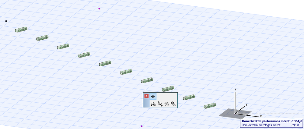

I'm working on a library part that is preferred to have two in x/y directions stretchable endpoints. (I mean I prefer to simply stretch it to anywhere and not to rotate plus edit its length).
Since it has to be fully stretchable, I want the same for its endpoint.
But it seems that I can merge the x and y hotspots _OR_ i can edit base, too.
If I want them at the same time, the base hotspots must be at the (y/x) base of the length, not at the end of the line.
In other words, if my object stretches from 0,0 to x,y; I want to have base hotspot at 0,0. But I can't: I have to place my x hotspot to 0,y and y hotspot to x,0.
Is there a sollution to be able to use just two hotspots?
