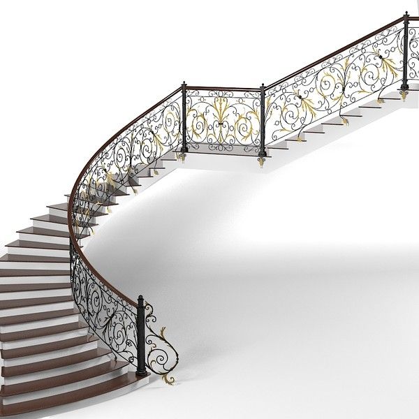

How can draw wrought stair (classic stair) in archicad?
Hi
Can someone help me draw similar to the image below.
Or give to me the object of this stair?
tanks
classic spiral curved stair wrought iron fore forged luxury elegant .jpge6debeb1-06ec-4eb5-9a30-6fa251539fe8Larger.jpg

The only way you will be able to do this is by creating objects. For the flat panels, this is easy. Use the slab tool and create the panel on the floor, view in 3D from the side and save the slab as an object (look up object making in the manual).
Unfortunately the curved panel is much more difficult. There are ways to do that via scripting parts or with Objective, but I don't think that there is a simple method.

tanks Erich..
No one can help me..?
