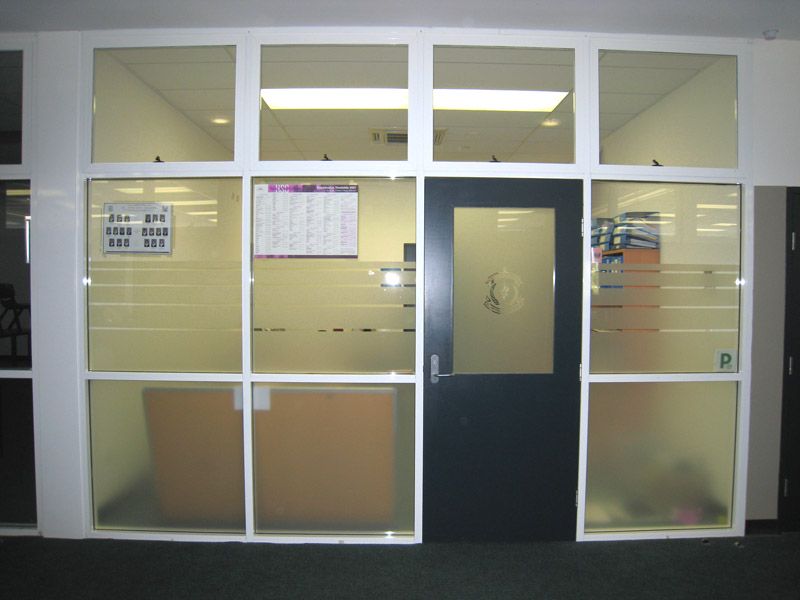

I am trying to build a series of window obects (or rather modify existing ones) to represent these windows.
I need fixed base with top hung awning BUT 3 ribboned or up to 4 at times..
As well as the opposite Fixed top with top hung transom..
I just can't seem to get it as one window with 3 horizontal sections.. and have bought a bunch of promising 'window building objects' that I fail to get work and only just end up with a bunch of code errors.
Any ideas or suggestions? : )

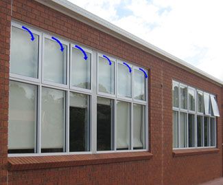

muzedesigns
See this is an example of another typical set up I am looking to replicate..
<frame>awning<frame>awning<frame>
<frame>window<frame>window<frame>
but because i am using individual window objects rather than ribboned i get:
<frame>awning<frame><frame>awning<frame>
<frame>window<frame><frame>window<frame>
Does Ganging correct this in AC11 cause i don't seem to be able to in AC10.
