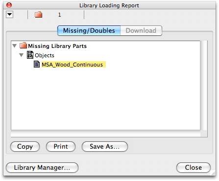

Brad wrote:It wouldn't be if it's been removed.
Yes I have but it doesn't show up in the Library Manager. There is nothing in the Libraries/Objects not found folder. I can't figure out where to locate it.
2008-09-03 02:42 AM
Link wrote:Exactly. That library part was discontinued in AC 9, and was replaced by DET_Wood (if I remember the right name). It is probably in an unlinked section or detail window containing the old MSA 'palettes', or perhaps as a Favorite. (Since 9, all of previously MSA-prefixed parts have been prefixed with DET.)
This looks like an old MSA detailer part. It probably resides on a detail or a worksheet. In any case, turn on all your layers and with the Object tool active, go to each and every window and hit ctrl/cmd+A and watch your Info Box for results.
2008-09-04 08:11 AM
Link wrote:I WISH there were a better way.
