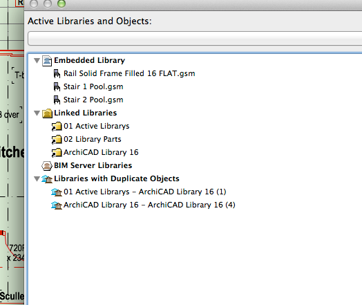

jakubc7
and my embedded library list ... no custom doors there

Can it be that those custom Door panel objects are in one of your linked libraries?

Jakub
They are part of the Aus Essentials Library and sit within
Australian Essential Library\AU Object Library\1. AU BASIC LIBRARY\1.2 AU Doors\Custom Panels
The file location might have the version numbers ie "Custom Panels 15"
You may have to extract the .lcf file first to find the panels but they are there.
