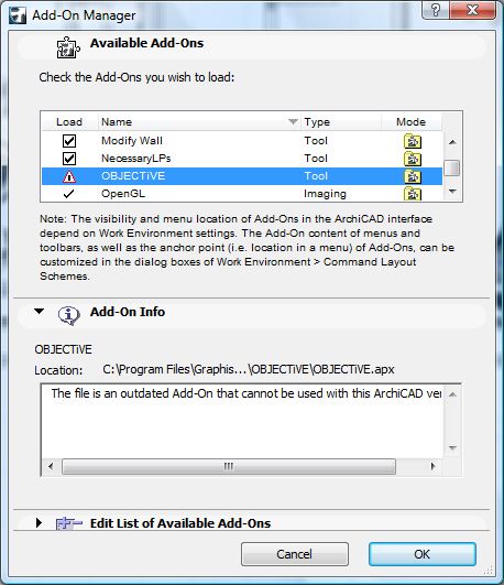

I've installed Objective, but I can't make it work. I've followed the Read Me-
manual.
I use AC 13 and downloaded the Objective-verson that should work with AC 13.
But it doesn't seem to work. It says the file is outdated.
Check the screenshot:
Ralph Wessel
Which platform are you using? Primarily, is it a 32-bit or 64-bit version of Windows? Check that you have downloaded the equivalent version of OBJECTiVE, i.e. 32-bit/64-bit. If you install the wrong version, ArchiCAD will refuse to load it.
Ralph Wessel BArch
Central Innovation
I use 32 bit and I downloaded the 64 bit version, hehe.
So I'm downloading the right one now
Thanks again!

Hi, I have the same issue with the installation of Objective. Only I have now tried both versions (64 and 32) and neither works so that is not the problem. Anyone have a clue as to what it can be?
Ralph Wessel
If you have any problems with software from Encina, contact Encina directly for support through the contact page
Include details of your platform, including OS and ArchiCAD version. Also, ensure you downloaded the correct version of OBJECTiVE for your ArchiCAD version.
