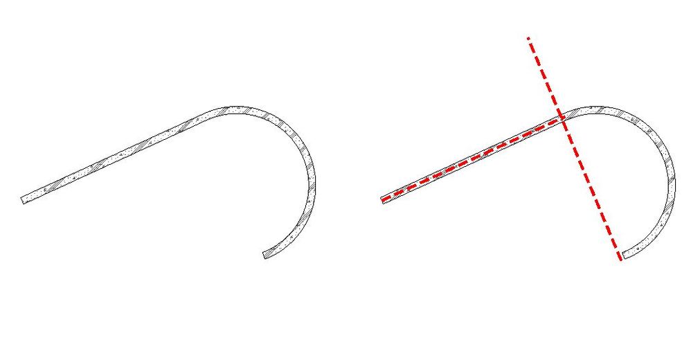

How to get the center of the curved wall
How to get the center of the curved wall?
GDL Reference Guide only show the WALL_DIRECTION & WALL_POSITION.
GDL Reference Guide:
WALL_DIRECTION direction of the wall
straight walls: the direction of the reference line, curved walls: the direction of the chord of the arc
WALL_POSITION absolute coordinates of the wall
array with 3 columns: x, y, z, which means the position of the wall’s starting point relative to the project origin
5 Replies 5
you have to calculate it based off its length and radius
thanks for reply.
another question:
how to get the wall radius parameter, I couldn't find it.
It might help to know what you are trying to build. If you are coding your own wall then you would be the one defining it.
I made a label for tracking wall reference, but curved wall cann't work.
