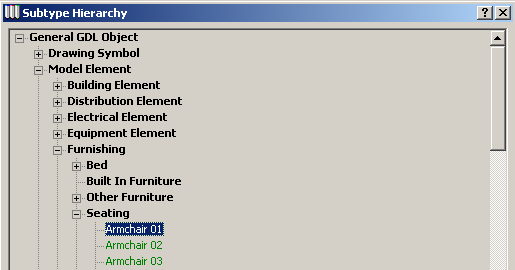

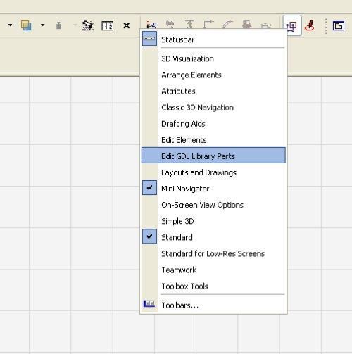

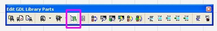

The only place you can check an element's GUID is the Open Object by Subtype dialog. To access this dialog, you need to turn on the Edit GDL Library Parts Toolbar (alternatively, you can add the Open Object by Subtype command to your menu structure through Work Environment)
In the Subtype Hierarchy dialog, you need to find your object in the Subtype Hierarchy tree. Library Objects will be displayed with green color in the list.

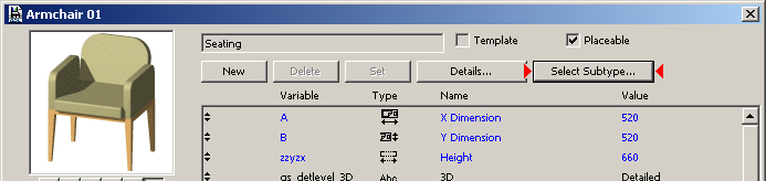

If you are not sure where you would find the library part in the hierarchy, then you need to check which "template" it belongs to. To do this, open the library part for editing, and click the Select Subtype... button.

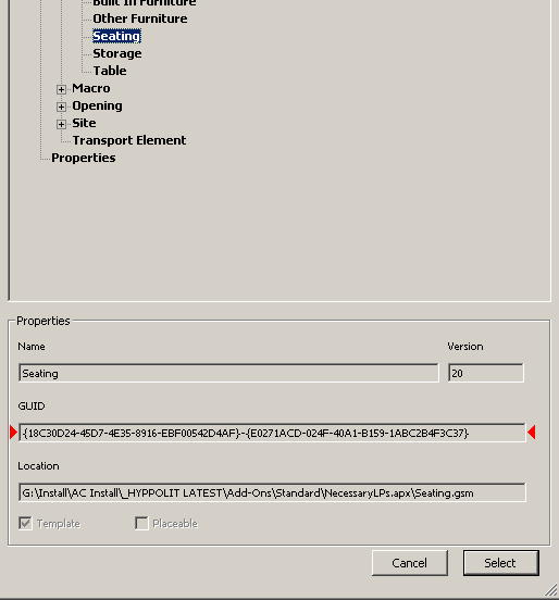

The Select Subtype...button of the Library Editor It will bring up the Subtype Hirearchy dialog. Note, the GUID you see here is not that of the edited Library Part, but the GUID of its parent element (template). In the below screen capture you can see that the selected element is not 'Armchair 01.gsm', but its direct parent element, 'Seating'. Its Name, Version, GUID and Location are shown.
You have to remember the 'path' of the library part in the subtype hierarchy, then go back to the Open Object by Subtype dialog to find out the GUID of your library part. If in any case there is a clash of GUIDs between Library Parts within loaded libraries, the Library Loading Report will notify you with a Duplicate Library Part alert. In this case, you will also see the GUID of the Library Parts involved.
