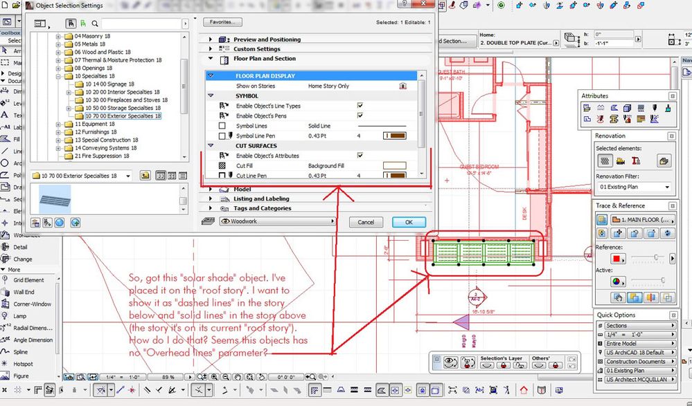

How to make the "solar shade" device linetypes?
rob2218
SEE ATTACHED.
i>u
Edgewater, FL!
SOFTWARE VERSION:
Archicad 22, Archicad 23
Windows7 -OS, MAC Maverick OS
8 REPLIES 8
Unfortunately objects don't have the option for overhead / uncut line types in the object settings.
Storey sensitivity has to be scripted into the object.
If this has been done then in the parameters (custom settings) you will find the options.
Like stairs allowing you to show and hide treads on different stories and changing their line types.
But if it hasn't been scripted in (and I am guessing it hasn't) then you are out of luck.
So it is either 2D line work in one of the stories or convert the object to a morph and then you will have the overhead / uncut line type control.
rob2218
how sad....back to resorting to 2D linework "ontop of" the 3D objects location....how very sad.
