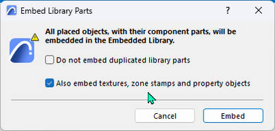

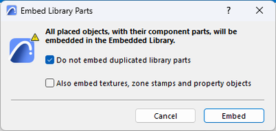

LeeJaeYoung
thank you
I did it again because it worked.
It must have been because I didn't turn on also embed....
Turn this option on and try again.
thank you ^^

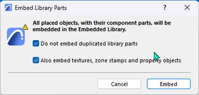

LeeJaeYoung
Which one do you want?
1
2
3
4

If you have created your own library parts in 26 then you will need to embed the library parts.
I would probably leave both options ticked (4).
I don't get any of those options when I save back as a 25 file, so I am not sure where they are coming from.
