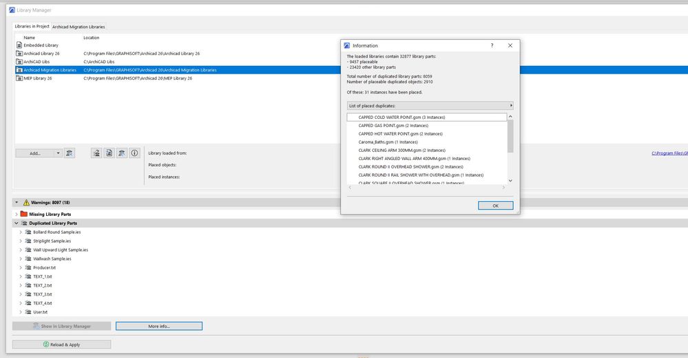

PLEASE HELP! Ive just started at a new firm and they seem to have some major issues with missing.duplicate library parts. I have found a total of 32,000!!! I assume most is from migration libraries but have no clue where or what to start to remove or fix this issue. Its creating major drag on loading and my connection with enscape.

I suspect you have the libraries loaded a second time as they may also be in the Archicad Lib folder.
I might be wrong about that.
Expand the duplicates to see what folders (libraries) they are in.
