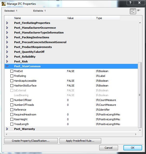

I would like to force the IFC parameters from my GDL object.
Is this possible?
I was hoping there was a way I could control this through my parameter script. Or is there another way to get the relevant measurements into IFC.
At the moment I am modifying my stair, so it can display
number of risers
number of goings
riser height
going depth
etc.
Thanks
Tom
1 REPLY 1
There are two options:
1. You can configure to export any parameter of any GDL Object to a custom IFC Property.
2. You can export all parameters of all GDL Objects placed in the file as custom IFC Properties.
The following video explains both:
http://www.youtube.com/watch?v=t8n4vo4KPhA
