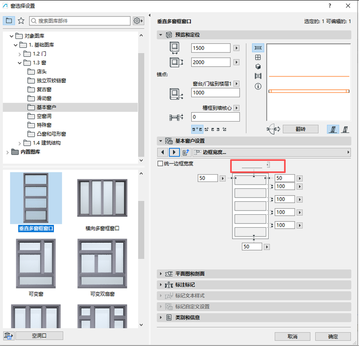

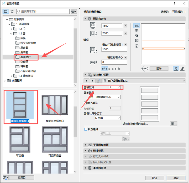

My colleague encountered an issue with a window: it's a vertically divided multi-sash window, and when the number of panes is set to 5, the width of the topmost frame cannot be modified. I have tested this in Archicad versions 27, 28, and 29, and the issue occurs in all three versions. Please see the attached screenshot for details.I suspect it's a button overlapping/obscuring issue — Archicad is in Chinese version.

Same issue since AC22 AUS. It is most likely due to the width of the "Uniform Frame Width" checkbox... Something that should have a 10 unit bounding box has a 250 unit one... You will just have to set the top frame width for a 5 panel window when set to one of the other panel counts...
