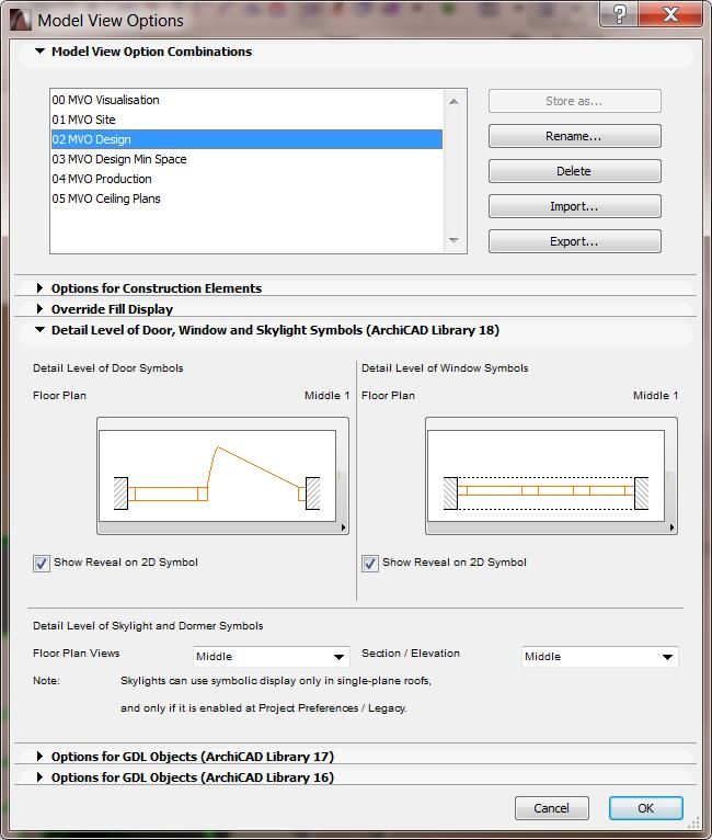

Thanks for the reply, but that option doesn't appear on my Model View Options tabs (see attachment)

Wrong tab - go the next one or the 2nd next (You have 17 and 18 libs loaded - I would try migrating so to consolidate lib)
