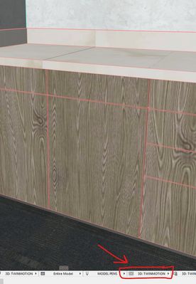

Hello everyone, I'm not sure what's going on but my knobs for my cabinets are not showing in 3D. Knobs are turned on with materials set, the 3D Detail Level of the cabinets is set to MVO, and the MVO settings for my 3D View are set to show all accessories, but they're not showing in 3D. Is there another setting somewhere I'm missing? Even if I set the 3D Detail Level for individual cabinets to Full they still do not show.

AllanP
Your template/file is corrupt.
It does not pass the value in the Model view option to the object, but it does store it.
I change the following library parts to work out where the error was.
the 0 is the "hide knobs value"
this shows a 1 for hide, but the stored value is a 0
when it is turned off it shows the 1.
this is a problem in the file, probably because you upgraded from an earlier version to AC24 rather than building from scratch.
if you open the file in 25 it fixes it.
you can then save the file down to 24, and the fix stays.
see attached file which was upgraded to 25 then saved down to 24.
if you save it down to 23 then open in 24 then the error reappears.
I hope your BIM Manager fixes the template.(or updates the Library so the knobs show up)

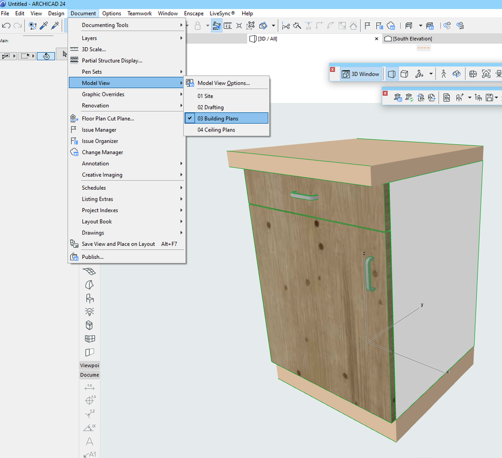

Jorge_Arreguin
CHECK THE MODEL VIEW OPTION
https://ibb.co/FV2sjnH

Jorge_Arreguin
can you send me a pln with that single cabinet ?

Jorge_Arreguin
I think i found it:
I did the following: I opened your drawing,
show 2d (F2)
select the 2 objects
press F5
select the two 3d objects and go to attributes

Jorge_Arreguin
I think looks more like a libraries problem in the web server , because when I copy paste the object to a new fresh open Archicad window, it show complet
