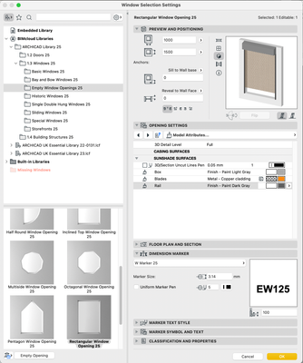

I need an object like this:
I have found several, but they are RFA and Archicad 25 wont let me import them, it is from the wrong Revitversion i guess...

This is a roller shutter door, and it's a standard object that really ought to be in the object library. There is a wishlist item for it.
In the meantime, someone on this forum told me you can use the empty window object with the sunshade option.
You can do things like this with it:
There are quite a few options that may work for you.
The 'high speed door and Garage door options are not at all the same. This is the closest.

The window-opening object in my library didn't have the possibillity of sunshade. So I D/L the object Rectangular Window Opening 17, with wich I did this:
But how do I change the look of the surface to something similar to your picture?
.Kamelite
Windows 10, Archicad 28
Not the opening tool but an empty opening object should have the sunshade option.
This is 26 but 25 should be the same.
In the material setting you can choose a 'perforated metal material' if you have one.
If not you may be able to find one in the new material from surface catalogue option.
