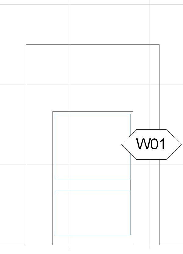

Here is a solution to this problem. I took the existing symbol and changed the GDL code to give the user the option to either turn the fill on (defaults to on) and if the fill is on, you can change its foreground, background pens and also change the fill pattern. The library part features the circle, the original rectangle (more of a diamond), the hexagon, triangle, and the "real rectangle" which is simply a square. the label picks up the window id and will use that for its text, which also is defaulted to on. Here is a quick picture of a hexagon label on a window and the label object.
