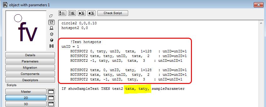

if I just use the text2 command, and set it at 0,0 coordinates. Can I somehow give it hotspots so that they can be moved around individually from the object itself?
It is possible:
you must add a "diamant" hotspot. This is the code in 2D Script window:
circle2 0,0,0.10
hotspot2 0,0
!Text hotspots
unID = 1
HOTSPOT2 0, txty, unID, txtx, 1+128 : unID=unID+1
HOTSPOT2 txtx, txty, unID, txtx, 2 : unID=unID+1
HOTSPOT2 -1, txty, unID, txtx, 3 : unID=unID+1
HOTSPOT2 txtx, 0, unID, txty, 1+128 : unID=unID+1
HOTSPOT2 txtx, txty, unID, txty, 2 : unID=unID+1
HOTSPOT2 txtx, -1, unID, txty, 3 : unID=unID+1
IF showSampleText THEN text2 txtx, txty, sampleParameter
In the Parameters Window add 2 variables for text position:
" txtx" and "txty"
2D Script Window:
Works like a charm!
Now I just need to sort out how I work it out for all of my parameter text2's individually from eachother but I guess that will just need some repeating and creations of a bunch of new txtx and y's parameters and more HOTSPOT2's.
