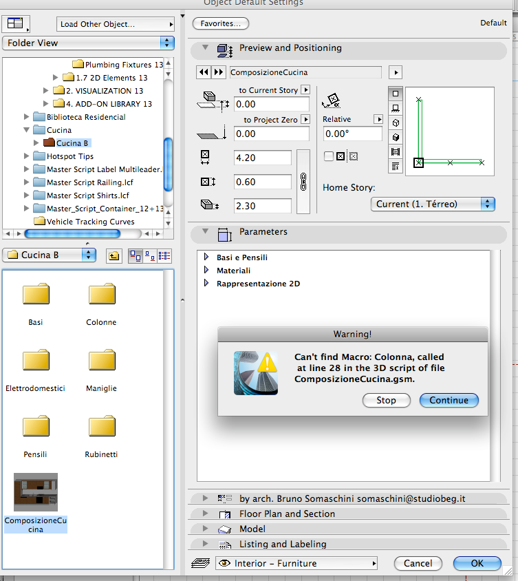

I want to know what I'm doing wrong, because I did put the folder Cucina with the two folders Cucina B and Macro B in my AC13 Library.
But when I try to use the object I get this error (see picture)
They appear in my active libraries.

The library part is missing a piece called a macro that is separate from the library part. You will have to get it from where you got the library part.

That object, made by one of our users, calls an object found in the standard Italian library. The funny thing is that it is NOT needed, so the error is boring, but the model is still complete.
Here is a modified version, that I hope works better.
Edit: 27/03
the UI page worked worst. Changed again with a new new version
