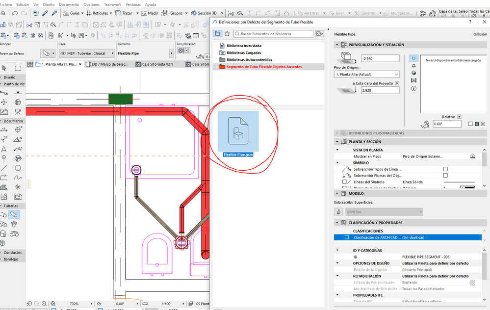

Hello, I created a file in Ac27, later I opened it in Ac28 but it doesn't recognize the Ac28 library, for example, the flexible pipe doesn't work, which I think is a library management issue.

hi, i loaded both archicad library 28 and mep library 28 but dont recognize the flexible pipe tool, when i open the basic library it show the 27 folder only
