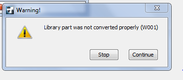

I've just changed from a 32bit to a 64 bit computer.
I am getting a "library part was not converted properly(W001)" warning when I try to use 3d. How do I convert this over to 64 bit?
Also, how do I find W001 - I assume that it's a window, but as I cannot see it, where is it?

Hi Hayley,
Yes, it's probably a macro for a window giving the problem - I don't think it's anything to do with your being on 64bit.
Which version of AC does this error occur in? (you should add this and your OS in your signature for better help on this forum)
Are you migrating a project from an older version of AC? If so, have you loaded all the relevant libraries?

I am running AC13, win7.
The link you forwarded does have a solution but unfortunately, for an Archicad dummy such as myself, I do not understand it.
I really do appreciate all the help I can get - the transfer to 64bit has proven itself to be a real headache.

Your chances of getting an answer won't increase by posting in more than one place. It's not a lottery. 😉
I'm using AC13 on Win7 x64 and I haven't seen the problem you describe. I do agree that getting 64-bit to work can, in general, cause some teething problems but these are not that difficult to work out now that drivers are more easily available.
The issue you're facing lies in some library object you're using. Are you getting this error with the default AC13 library?
Try using the marquee tool to select only half of the project at any given time. and press F5 to view that in 3D. Then, repeatedly halve the marquee area until you find the offending object.
If you suspect it's a door/window causing the problem, remember that it's likely to be in more than one location. In that case, maybe select a portion that has the door/window and, if you get the same error, temporarily delete that door/window and try again. If the error is gone, you will easily have your culprit.

The problem is finally solved!!
Solution - TURN OFF THE SECURITY SOFTWARE WHEN INSTALLING.
Simple - worked perfectly.
