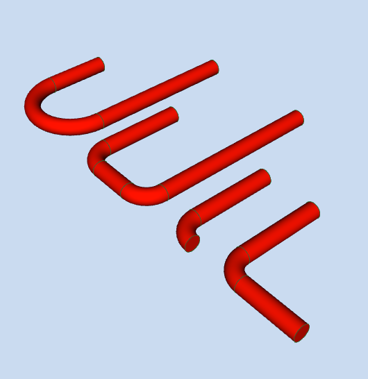

values "return_type" `Simple U`, `Square U`, `Simple L`, `Square L` values "overall_l" range[elbowrad+0.25",] IF return_type=`Square U` THEN values "wd" range[elbowrad*2+0.25",] ENDIF IF return_type=`Square L` THEN values "wd" range[elbowrad+0.25",] ENDIFBelow is the object that I plan to use as a simple fully parametric railing return solution, which I always had to put together from basic solids.
