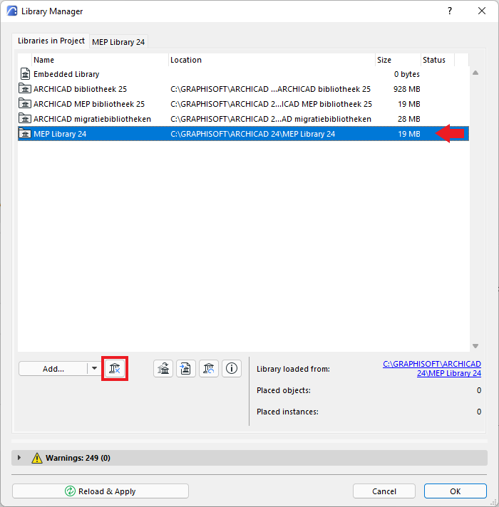

Migrating projects from previous versions to Archicad 25 NED
Navigate to File > Libraries and Objects > Library Manager, select the MEP Library 24 and click the Delete button to avoid having duplicated library parts or missing library in the project.
Migrating projects from Archicad 25 NED to Archicad 24 NED
The Library Manager will report that ARCHICAD MEP bibliotheek 25 is missing. From the Library Manager (File > Libraries and Objects > Library Manager), select the Missing library and click the Delete button.
To add the MEP Library back for the project in Archicad 24 NED, in the same Library Manager dialog, click Add button. Browse to the installation folder of Archicad 24 NED, and select the MEP Library 24 folder.
