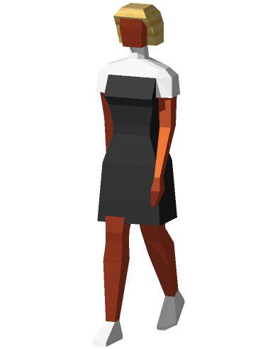

You might recognise the girl in the attached JPG? The
legendary "Woman in Red Dress" is now a tanned blonde with a more modest dress, suitable for Dubai.
