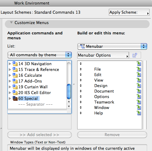

Hello,
Activating the Special menu in the preferences does not create
a menu, it just makes the special menu commands visible in the
work environment settings.
In the work environment settings browse the command list by theme - the special menu commands should be there in a folder named '60 Special'.
From there you can add them to a new or an existing menu as you wish.
Hope this helps.
tsturm
Thank you Juda, I was missing the location of the theme for the special menu. I was looking in the list of menus and commands. Off to update several library sets, now that I can place the whole lot of them on the screen at once.
