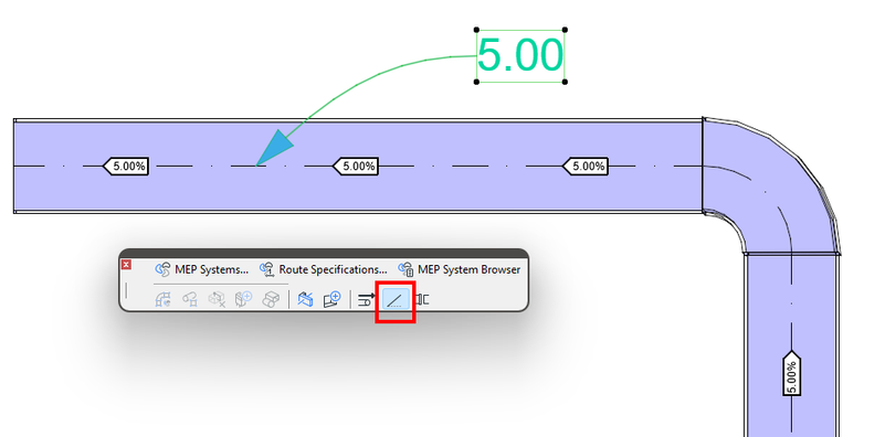

Hi, anyone tried to use MEP label in archicad 29, and saw that it is not there.. any solution for that? cos the other labels are not for MEP objects. It used to be somekind of a property label.. and now its gone.

If your system route has a slope you can show it for display in View> On-Screen View options> MEP Slopes or by turning on the Window> Toolbars> MEP toolbar.

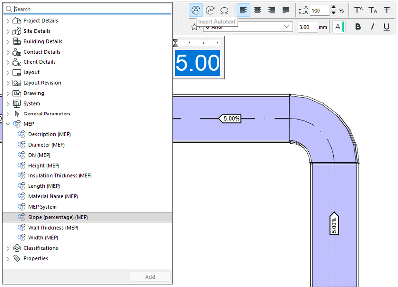

If you desire to create a custom label with Autotext that property is also available as MEP> Slope (porcentage) MEP.

There was a dedicated MEP label, I’ll use the autotext instead. Thanks for your responses.
