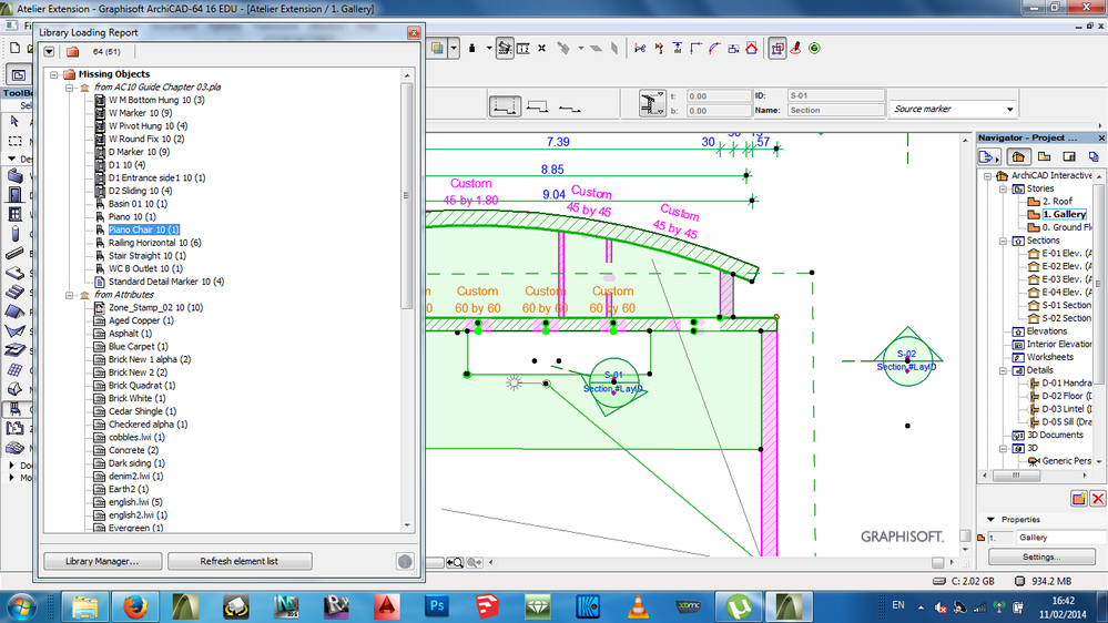

This is my first post and i decided to sign up because from looking at other posts to try and help me with my problem, none seem to give me the answer that i need. So here goes.......
I started a project a couple of years ago in ArchiCAD 10 by which i was given chapter guides from my university lecturer. Every chapter would generate a new part of the building myself and the rest of my class would have to build. After completing the building i decided to try and update the design i had done but by this time i had installed ArchiCAD 16, and the problem i am having is that certain parts are missing in the (from AC10 Guide Chapter 03.pla such as W M Bottom Hung 10, Basin, etc and in attributes materials etc will not show in ArchiCAD 16. What i need to know is how do i show all the elements that are missing in the model so i can move them delete them etc as otherwise i will probably have to redo the entire building again. I'm sure i have managed to do this before but i cannot remember how to do it. I have included a screen shot so that you can see what is missing as there is alot!
Any help would be much appreciated.
Thanks,
Simon
1 Reply 1
David Maudlin
Rockstar
Simon:
One option is use the Library Manager to load the ArchiCAD Library 10 Subset library, it should be in the Graphisoft > ArchiCAD 16 > ArchiCAD Migration Libraries folder. This assumes that these parts were from the standard ArchiCAD libraries.
