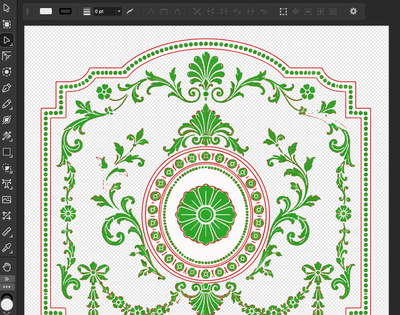

1. Point cloud scan existing details and model based on that. Or I'm sure you can find pre-modeled details online. Those will not be editable however.
2. AI -> 2d -> 3D ish. If you only need to have some semi-generic, embossed details, you can always ask chatgpt/claude/gemini to produce a 2D view of details starting from reference images. You can take that output, plug it into affinity vector (free software) and export it from there, vectorized as DWG. You can then take that dwg, use slabs to "fill" it and you'd have a 3D element that would look 3D but not very intricate.

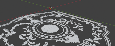

(you can maybe freestyle some heights, by importing the vector as svg into Blender 3D (another free software) and then selecting random points (theres a function for that) and then raise them so that they apear "sculpted".  Note that this will look very bad up-close.
