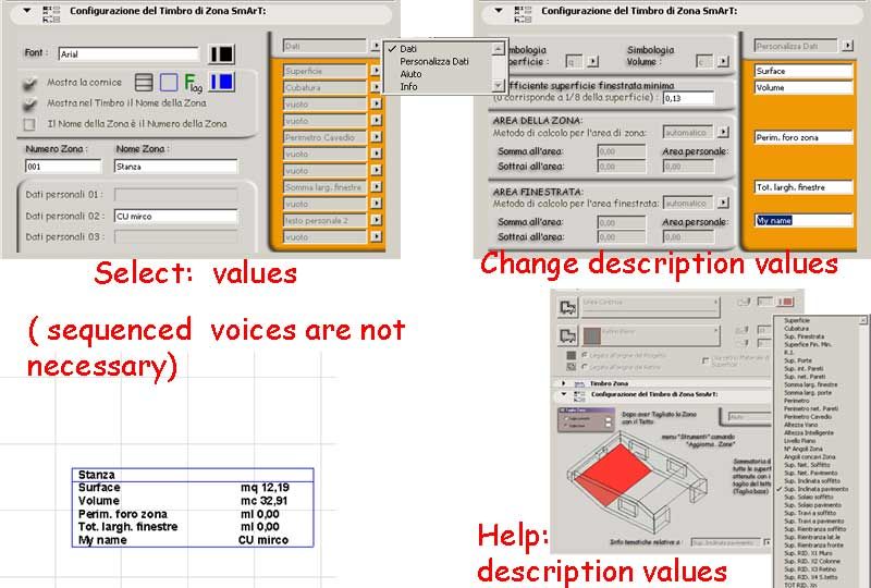

these are the voices
surface
volume
windows surface
illuminating relationship
doors surface
walls up inside surface
wall up clean surfaces
summation windows width
summation doors width
zone perimeter
walls perimeter
hole perimeter
zone height
intelligent height (middle height under roofs)
store height
number angles zone
number angles concave zone
clean ceiling surface
clean floor surface
clean ceiling surface (slab)
clean floor surface (slab)
tilted ceiling surface (roof)
tilted floor surface (roof)
ceiling surface (clean beams )
floor surface (clean beams )
ceiling surface (niches )
side surface (niche )
frontal surface (niche)
a) reduction surface (wall )
b) reduction surface (column)
c) reduction surface (fill)
d) reduction surface (under roof )
reduction summation (a+b+c+d)
remaining surface
reduction's value
total reduced remaining surface
personal text 1
personal text 2
personal text 3
empty
You can insert max eleven of these names
with personal sequence
