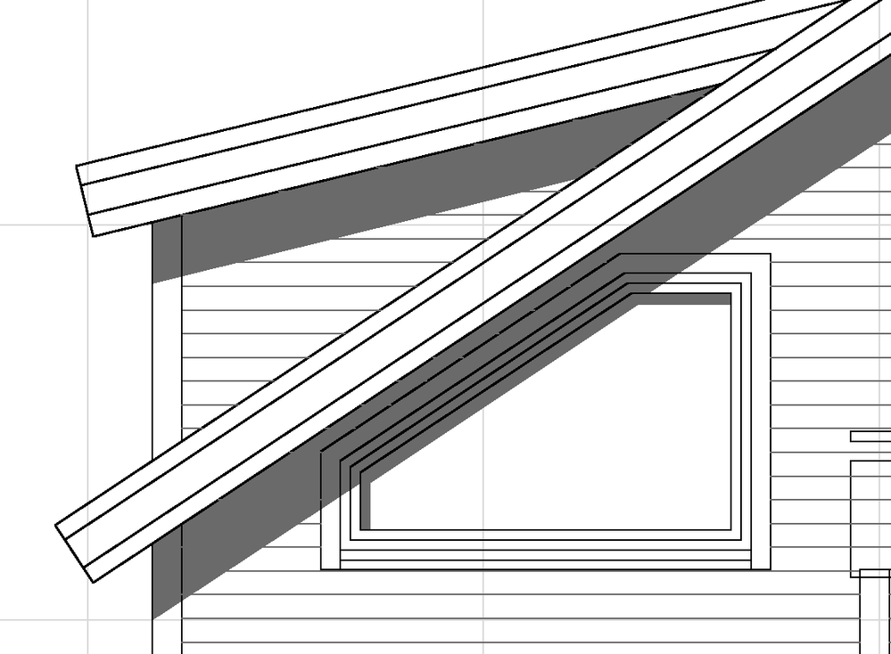

I am sorry if this topic was solved before, but if anyone can suggest me how to modify trapezoid window (or any other way - though I've tried to make custom window by saving a selection as window and then the hole in the wall still becomes rectangular) to this shape as in attached picture.
Thanks in advance,
V

The custom window method will work, but you need to add a Slab with the ID of "Wallhole" that will define the hole in the Wall (rather than being rectangular). In the Help files see: Elements of the Virtual Building > Parametric Objects > Graphic Creation of Custom Library Parts and Components > Saving Custom-Shape Doors or Windows.

https://bimcomponents.com/GSM/Details/21360
You can drag this from the website from the downladbutton direct into Your Archcad-window to download it.
Tutorial:
https://www.youtube.com/watch?v=HJLPn90GrFQ&feature=youtu.be
Tutorial:

David wrote:I read this once... and forgot about it. almost removes the need for parametric options... almost. but bravo used it to make pool water a skylight so the client can swim in bimx
