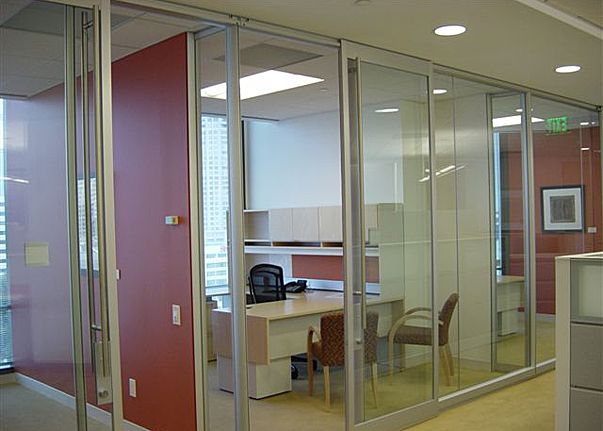

It would help to understand what you are after by a few photos

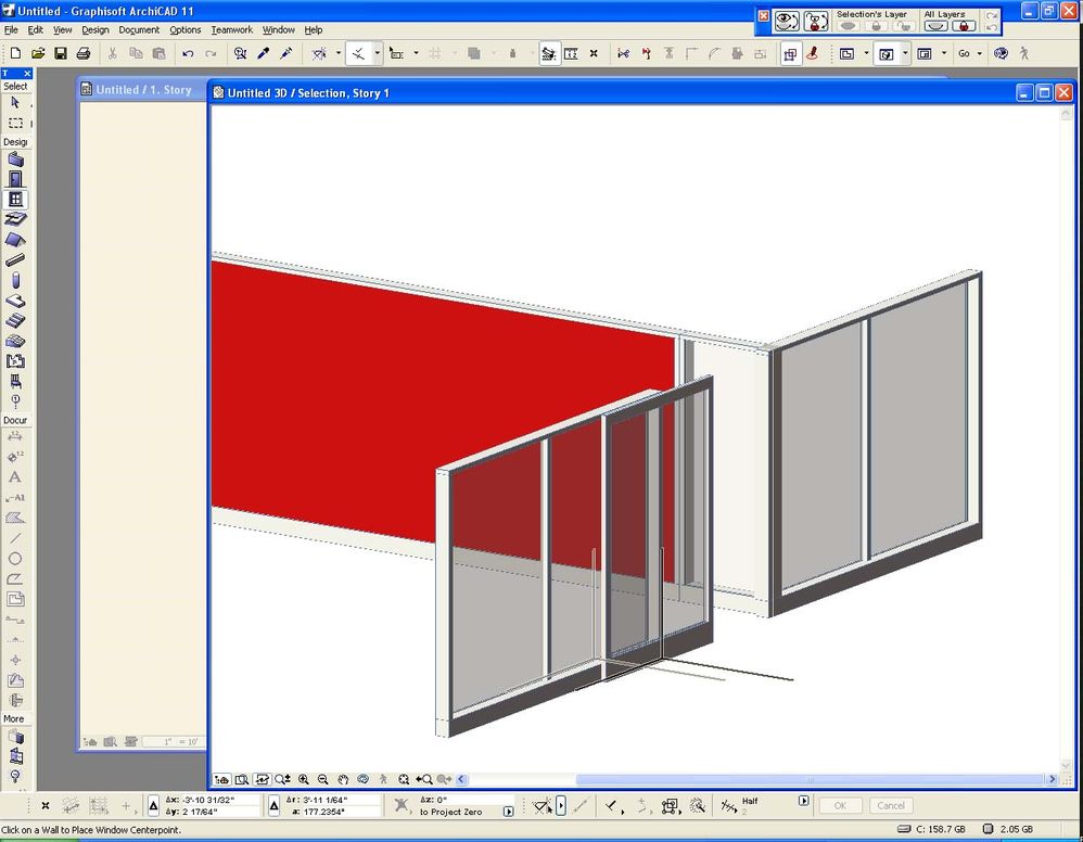

Here is what we are after. Including the doors.
undefined
Erika Epstein
Make int walls the width and height of the panel system.
Use the storefronts to create the fixed panels, both glass and red.
Place a sliding door that sits outside of the wall. Set it's panel to match the system.
You will have to make a custom library part for the door handles as no AC ones match what you show.
Is possible to insert a storefront in a wall without any door?
Is possible to place two doors at the same time in a wall, sliding door and storefront door?
Sorry for asking, I am trying to understand your suggestion, Erika.
