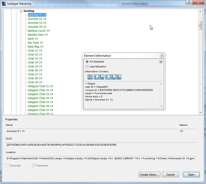

Of course you're right. They were calling the object by name, but the 'outside' object always had the same GUID. Sounds like a good idea to me, so we can avoid all this nonsense.
BTW Frank I couldn't see the GUID in my Element Information. What's the trick?
Cheers,
Link.
Hello Link,
I tried finding the GUID in the element information pallet but it did not show.
I tried this in AC 10 and in AC 12 trial version. No show in either version.
Frank is using AC 14 and maybe that version has an improved element
information pallet. Are you using AC 14 ? You don't say in your signature.
Maybe if you are not using AC 14 that could be the explanation.
Thanks,
Peter Devlin

Hi Peter
That screenshot was from AC14. I thought perhaps Frank may be using it inside the Object Editing environment somehow? He hasn't been wrong before so I don't want to doubt him now!
Cheers,
Link.

Frank Beister
I hope I haven't wasted your time. I was looking for some other problems and have seen beside that the "unique ID" is listed in the element information. But this is obvisiously not the GUID, I fear. Sorry, that you have trusted me.
See screenshot attached, which show the different information source for the IDs. The used object, I wrote for selfGDL I will post too.
