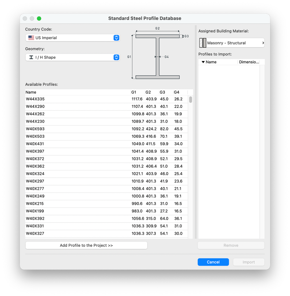

Can you use complex profiles? I still see an international assortment of steel shapes in metric and imperialScreenshot 2026-01-29 at 1.58.19 pm.png

I've never used complex profiles.....just never needed them.

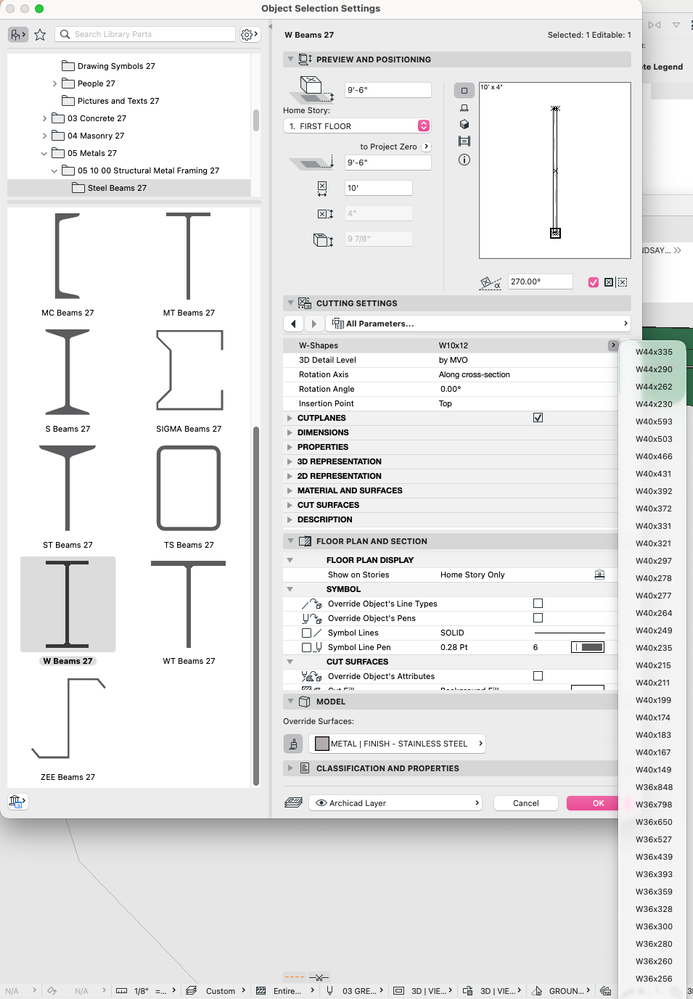

Having the same issue! The Archicad Legacy Objects USA.lcf is the 2D detail symbol, NOT the 3D W object (see screenshot of what is missing). Double checked the Archicad USA Template 2, does not have this object. This is a very used object for our structural coordination, way faster than complex profiles, better selection nodes and easily managed (imho).
The only solution I have found is to export the objects from 27 and import them into our embedded library 😕 which means we're just carrying around outdated objects which seems to negate this whole transfer to a global library!!! How can we get the legacy library update to include these disappearing objects OR come out in a library update??
