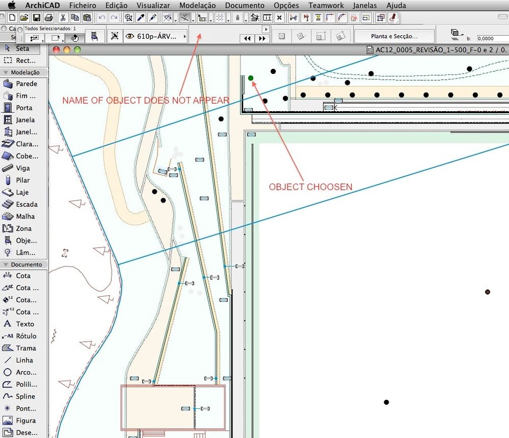

When opening a document with AC12, objects are missing.
When selecting an objecto (the dark dot) it is impossible to read the name and open the object dialogue window! (see attached file)
Obrigado.
Thank you.

SeteSete:
You are missing one or more of the libraries that that file uses, in the AC 12 Help files see: Configuration : Libraries : Missing Library Parts and the Library Loading Report Palette. If the file was created using an earlier version of ArchiCAD, then either the earlier version library or the migration library for that version should be loaded.
David
David
