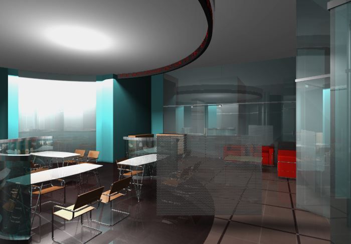

Dwight,
I used your setting and came up with this.
If I wanted to show more metal and less holes would I have to create another "dot" pattern to use?
Why is the metal part so dark?
Thanks as usual for all your help..

Dwight
Erase a hole.
Metal part needs more reflection.
