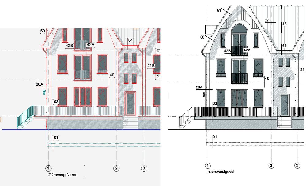

Is it possible to create my own personal drawing titles?
I just want a drawing title shown on the right site of this picture. I always have to change it manually. It's not possible to change it in the drawing selection settings.

Hoi Charlotte,
We never use the titles and just use text instead in the views.
You can insert autotext for Drawing ID, Drawing Name, Drawing Scale etc etc
Might not be what you are looking for, but we got annoyed by the drawing title limitations as well and this workaround works well for our layouts. Maybe it works for you

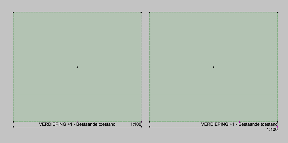

Have you looked at the drawing title options? I have a selection included with AC19 that includes "Linear Drawing Title 19" which looks exactly like the one on the right.
The standard titles are quite flexible.

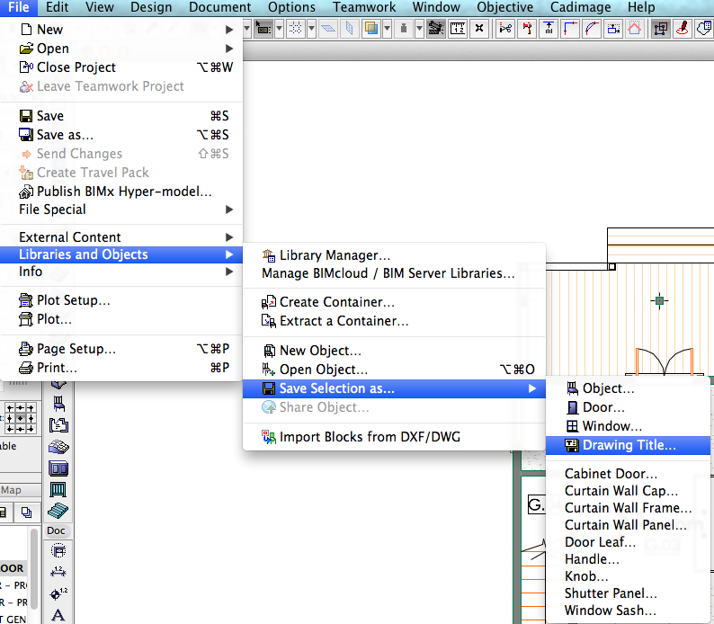

You don't have to know GDL. Set up text and lines etc. the way you want to see it (in a 1:1 view might be best), using Autotext for Drawing Name, number, scale, whatever you need. Select the elements and go to File> Libraries and Objects> Save Selection As> Drawing Title, and you have your very own title for use at any time.

That's a bit simpler than the label tool ! Thank you Stuart.
That to me looks like the best solution Stuart.

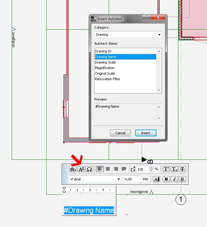

Just one problem, where to find autotext ?

Click to create your text object. When the text window opens the second button from the left in the menu bar has an "A" with a couple of "rotating" arrows, click that and select your required autotext.
Erwin Edel
Rockstar
Or to put it into picture.
