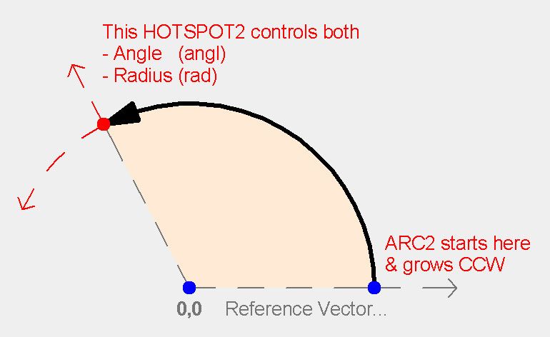

Hi All!
This forum is proving to be incredibly helpful,
so here I go once again...
As my Trigonometry is close to non-existent, I need some help
with finishing off this attached Slice-of-Cake object.
I'm sure it actually is a piece of cake... 🙂
1. I need to create a SINGLE HOTSPOT2 that will control both
the RADIUS & the ANGLE of the given ARC2.
In the current object I only have control of the Angle,
as the key code was pretty much copy-pasted from Fabrizio Diodati's
reply in this post:
http://archicad-talk.graphisoft.com/viewtopic.php?p=2533&highlight=hotspots+angle#2533
2. Also, due to the pasted source code, I need to rotate the
start angle of the functions & ARC2 back to 0 degrees.
They currently are set to start at 90 degrees which is NOT what I need.
Here is a the 2D script code for quick reference:

Thanks -
Gil

And the half baked object...
You can not mix length and angle for a same hotspot.
In result, only the first hotspot (declared in tab parameters) will be active.
You could achieve this with x, y coords of the hotspot. I would avoid this (trigonometric calculations needed).
Better to script two hotspots, with distinct locations.
uid = 1    ! first unique identifier
!!! ---------- radius ----------
hotspot2  0             ,  0             , uid, rad, 1 : uid = uid+1    ! base (anchor)
hotspot2 -rad*cos(ang/2), -rad*sin(ang/2), uid, rad, 3 : uid = uid+1    ! ref
hotspot2  rad*cos(ang/2),  rad*sin(ang/2), uid, rad, 2 : uid = uid+1    ! moving
!!! ---------- angle ----------
hotspot2 0           , 0           , uid, ang, 6     : uid = uid+1     ! centre
hotspot2 rad         , 0           , uid, ang, 4+256 : uid = uid+1     ! base (editable)
hotspot2 rad*cos(ang), rad*sin(ang), uid, ang, 5     : uid = uid+1     ! moving
ThanX!
I pretty much ended up doing something very similar.
Gil
