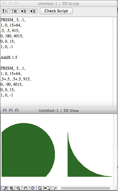

Hey i'm a student and i'm having problems with creating a PRISM_ with curved lines. can you help me please
this is the code
1, 0, 15+64,
.5, .5, 915,
0, 180, 4015,
0, 0, 15,
1, 0, -1
This is a code that makes a curved line to the outside. the line i used was the diagonal line in the triangle. now the question is how can i make this so the line is curved to the inside

Hello,
Using a negative angle (-180) might help
Juha wrote:
Hello,
I tried that but that isn't the solution

jensvs:
The center of the arc (status code 915) needs to be moved out, the direction of the arc needs to be reversed (negative angle) and the angle should be 90˚, not 180˚. When working on these sorts of problems, it helps to draw the shape desired to work out the code.
